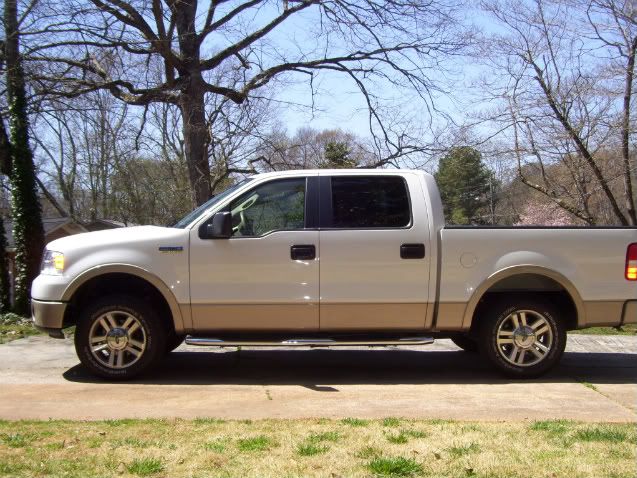

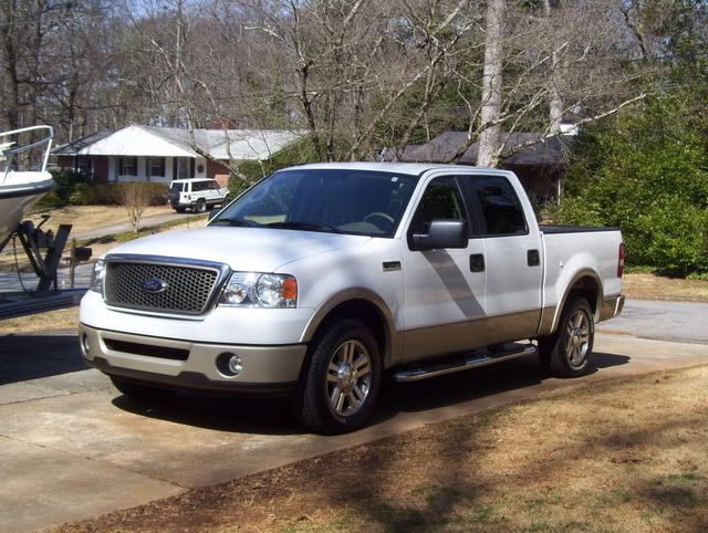

decided to go w/ Hell Bent Steel 2 and 1/2 in leveling kit. ALMOST perfect. Now she sits exactly 1 in. taller in the front. But, love the drive stance, much to my delight:

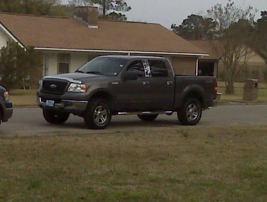

Reply author: doghouse241
Replied on: 04/10/2010 18:16:33
Message:
Here's how mine came out after the leveling kit and some 285/75/r17 goodyear duratrac wranglers wish I woulda went a few sizes bigger but they said this was the biggest I could go with out rubbing the fenders
