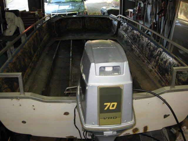

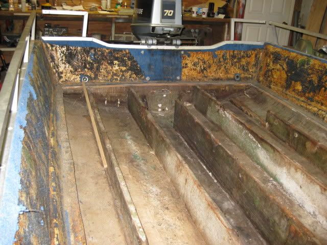

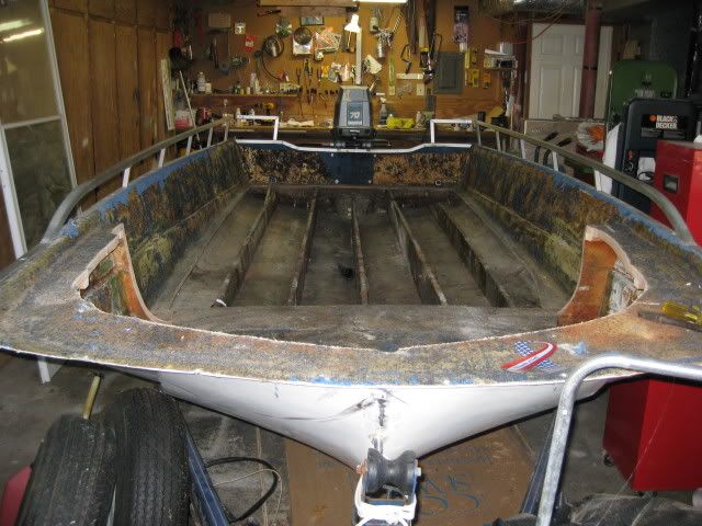

Now that the Mako is headed to Bobby's, I am going to be cutting my teeth on my boat. This boat was my grandfathers and has been in the family since before I was born. It has had a few transoms and floors over the years. I think the last time it was re-done was 1988ish? The floor was shot from the console back. The transom is very soft. The engine is strong and just needs some paint. I plan to take this slow and learn as much as I can.
Right now I know the stringers, floor, console, and transom are the most obvious. Some decisions that are still up in the air are to go back with carpet or go with an anti-skid? The motor is ok but I'd love to see what a 90 opti would do on it. The trailer was custom built for the boat but is covered in surface rust. It will be totally redone.
I am open for all ideas, suggestions, and comments. I have caught a ton of fish and have even more memories so I guess that's why I'm not trashing it.
Here is the current condition. You can see the casting deck out line in the bow. I will plan to keep it.

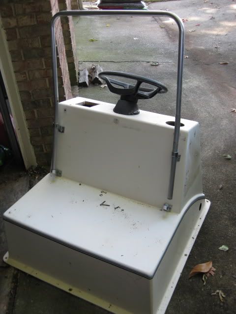

I've been talking to ScottC about some ideas for the console. Not a lot of room!

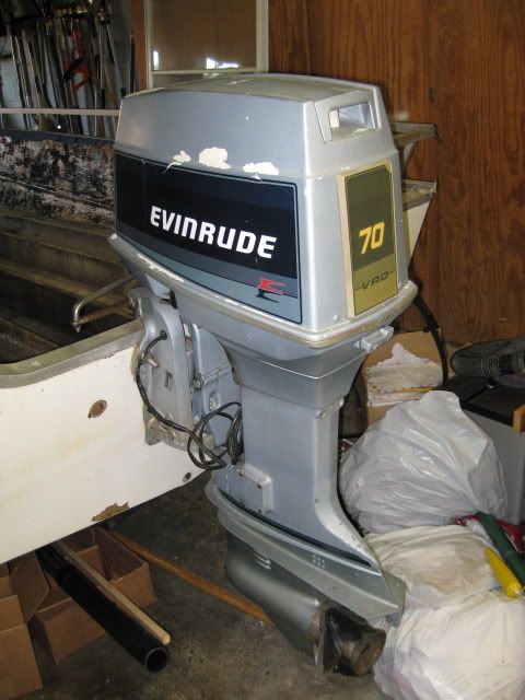

Based on the Model # this is a 1985 70 VRO. If there are any Rude experts, please let me know if this is right. I thought it was newer than 1985?? The VRO quit working one day and threw a rod. It has since been rebuilt and runs fine.
The paint was Imron. Every inch below the water line has blistered.
The stringers are very week and some are beginning to disappear!
Bad blisters!

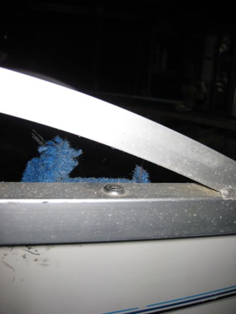

The rails are in great shape. I'm all open for advice as to how to get these screws out!
A little damage from a bad storm tied to the dock. The endcap for the rail is ok.
After the stringers are replaced, I plan to fill the bottom with foam.

You need a 90deg screwdriver to remove those screws.
http://www.sears.com/shc/s/p_10153_12605_00941315000P?vName=Tools&cName=HandTools,GeneralPurpose&sName=Screwdrivers&psid=YAHOOSHOP01&sid=IDx20070921x00003b
Or something like this.
http://www.hony-group.com/newEbiz1/EbizPortalFG/portal/html/ProductInfoExhibit.html?ProductInfoExhibit_ProductID=c373e9195b4527fd8f7bcf41a5030930&ProductInfoExhibit_isRefreshParent=false#

Cool looking project. I guess I would start by asking what I was planning to use the boat for? My guess is some skinny water fishing? I like the idea of the casting platform up front, maybe thinking of some lockers up there for storage, etc?
The original pics seem to show the ladies sitting in lawn chairs, what is your plan for seating?
Looks like no internal fuel tank, going to stick with that?
As for the carpet question, no doubt in my mind I would do non skid and leave the carpet out. Good luck and keep the pics coming.

The boat will be used around the middle Tennessee lakes for fishing and family fun/water skiing, ect...(that's why I want to see if a 90 would work. That 70 struggles bad with a skier)
Yes, the casting deck will be put back in. My Dad designed it when we last redid the boat 20 years ago. We had a seat up front with a trolling motor. There was just open storage under it but I'd like to go further and maybe make some compartments and house a 2nd battery for the trolling motor.
The boat is very weight sensitive so I can't go too far off the deep end. I'd love to figure out a live well set up (help Wart)
The gas tank and batter will remain, as designed, under the console. I thought about putting one in the floor but thought that was getting out of hand.
I really don't want carpet back in it. As far as seating, there would be a seat behind the console, and sit on the console. The other person just finds a place. No lawn chairs on my boat (even though I'm from Alabama) Thanks for the feed back.

Install a rigging tube that will go from the console forward under the casting platform while it's opened up.
This could be used for power to the trolling motor and lights.
Triplecrownnc
TC
11412 Posts
Posted - 11/03/2008 :  19:13:51  Show Profile  Reply with Quote
I can only think of two ways you could go about a live well as a below deck well is not an option here.
You could have a completly removable topside well that you connect and disconnect the feed and drain lines when using the well. You usually see those in the rear of the boat in a corner.
Or you can get a little more fancy and put the lines under the sole and have maybe one of those leaning posts behind the console with an integrated live well in it. Put some shut off valves in the bilge. That would be cool but it would mean dropping some cash for the leaning post.
If the boat is a little sensitive and you are putting a heavier motor on the back, maybe it would make some sense to get the live well more up by the helm, just a thought!

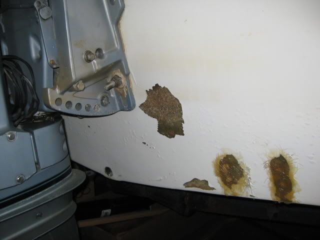

Your Dad told me that this boat was bad about taking water over the transom. He didn't elaborate any about it, so I don't know if it came from cutting the throttle quick while on plane?
But still you might think of installing a raised splashwell on this redo. Just be sure that the motor can tilt.
n/a
deleted
3080 Posts
Posted - 11/07/2008 :  10:39:06  Show Profile  Reply with Quote
The water that came over the back was usually do to his piloting techniques. Do you think a 90 is too much motor?

That one screw is in a tight spot!
Make sure to clean out any deposits inside the screw head.
If you had the room use a Craftsman speedhandle. You can put all your weight onto the head of the screw.
A good trick for getting a good grip on the screw head is to use a dab of valve grinding compound on the tip of your philips head it.
We also use what I call a pneumatic screwknocker, but you need to be careful you don`t apply to much air pressure.
I have worked with alot of scews that are shanked, stripped or corroded.
Hopefully you won`t need a 90 degree drill to get in there to drill off that head!
Good luck with that project!

When you get back to removing those screws, if you can loosen them with a 90* screwdriver as Wart and others suggested. Then, if they are being too tough, slide a hack saw uner the rail and cut. Just leave enough hanging up that you can grab the screw shafts with vice grips to remove the rest. Neat doing a project that has been in the family. My brother and I rebuilt a duck hunting boat a few years ago my father designed and built when I was 6. It was cool taking our kids out in the boat their grandfather built (even if he passed away years before they were born). Good luck when life affords you the time to get back to the project.
Another thought to fashion a livewell on a dime, use an Igloo cooler with tie down accessories. It'll double as a bench with accessory cushion. http://www.jamestowndistributors.com/userportal/show_product.do?pid=7945&familyName=Igloo Cooler Accessories We sell quite a few of these for that reason. You can pick them up at JD or most anywhere that sells coleman coolers. You could plumb livewell hookup that can then be disconnected when and left on shore when you're barging that VW on there What a cool boat, never seen one a those before! Just a caution on this idea, if you're running hard I'd put some extra heft into the security if it's full of water. Backing plates under with G-10 http://www.jamestowndistributors.com/userportal/show_product.do?pid=8758&familyName=G10 Fiberglass Board or starboard or something of the sort and some extra strapping. This route is great b/c cushions are cheap compared to custom, makes for sizable bench seat, doubles as storage when you're not fishing and comes out easy.
BTW- Got same vintage 115 Evinrude that needs some TLC but will get us through til we can swing a new powerplant. Interested to see how this one comes out. Good luck
My favorite tool for those little buggers. If that is just a 90 angle and open from one side, cut it!
http://www.jamestowndistributors.com/userportal/show_product.do?pid=3329&familyName=Fein MultiMaster Universal E-Cut Saw Blade 1-1%2F8 inches Wide It's the best tool for this purpose, better than sawzall for precision cuts. Bought one for kitchen floor job and never put it away, use it a ton on the boat.
