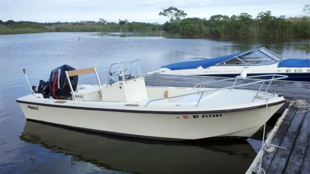

Hey Guys
So back in the Spring/Early Summer I purchased a nicely preserved/Restored 1988 171. It's Powered by a 2004 Mercury 115 4-Stroke. Yes I realize the boat is tail heavy.
Since the day I purchased the boat running under power it shows a list to port. If someone is standing on the port side while running under power it's pretty bad. So much so I have to stand to the starboard while driving the boat to get it close to level again.
One thing to make mention of is the boat is equipped with "smart tabs". http://www.nauticusinc.com/smart_tabs.htm
Today I disconnected them to see how the boat would preform without them. No doubt I got plenty of bow rise on acceleration and some porpoising however the boat tracked noticeably straighter. It dose still have some list to Port.
Ill be pulling the boat I figured mid November depending on the fishing. At that time I'm strongly considering removal of the tabs altogether.
Suggestions and comments are greatly welcomed.

Ill get the photos when I pull her next month. Till then all I have is this (I hope this works! I think if you go straight to webshots you can see a much larger photo of the boat/tabs) )
[URL=http://outdoors.webshots.com/photo/2309582920104533319EKmbCL][/URL]
http://inlinethumb26.webshots.com/49561/2309582920104533319S600x600Q85.jpg
http://image87.webshots.com/187/5/82/92/2309582920104533319EKmbCL_fs.jpg
Mine are the stainless ones, with a healthy growth of algae on them.
The boat does not "wonder from starboard to port ". What it does do is immediately list "x" degrees to port no matter where the throttle is and the boat is under power. If my fishing partner stands with me on the right side of the boat, we can correct it. If we were to both stand on the left side of the boat.... it would be not good!

TommyD11730
143 Posts
Posted - 11/06/2011 :  16:37:30  Show Profile  Reply with Quote
Dave your last post got me to thinking.
Anything is better then cleaning the seasons grunge off the boat so I decided to do a thorough tab and actuator inspection. Here is what I found.
The Port side actuator requires less pressure to retract. <I tightened the actuators to the tabs as they slipped yesterday> Once retracted it will not descend on it's own! To make 100% sure it was not the piano hinge binding I disconnected the actuator from the tab.
So I have got to wonder if at times the port side would not descend. If so, and the starboard created lift, as it was descended that would account for the list to port.
Make sense?
dahlbebop
1260 Posts
Posted - 11/06/2011 :  19:23:29  Show Profile  Reply with Quote
Make sense?
Could have sworn I mentioned checking for sticking actuators.
Anyway, you have found your problem. On early models they had actuators that were replaced by upgraded models. Don't know if yours are that old but because you have the slotted mounts I would guess they are old. Call nauticus and see if they will send you some replacements. Replace both sides!
