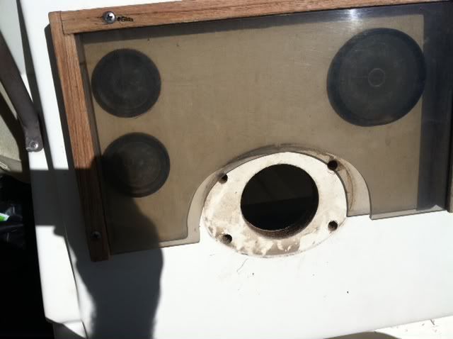

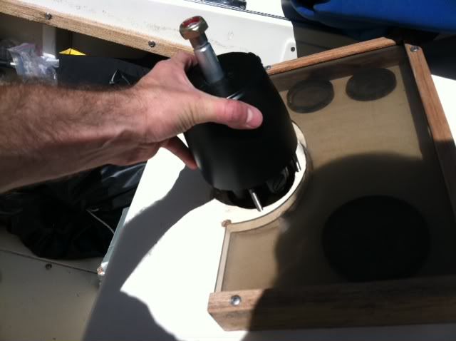

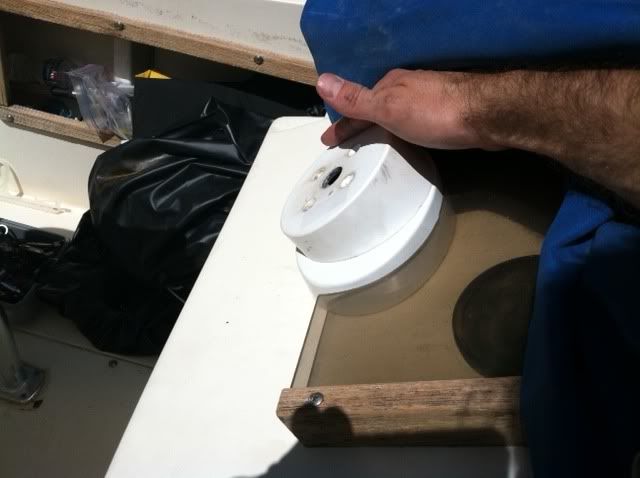

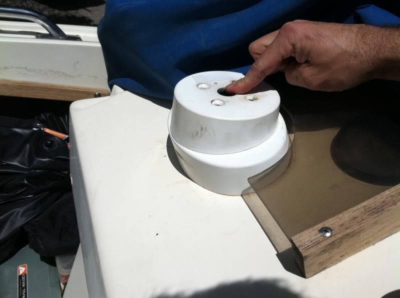

Well I got the cables disconnected, I just need to cut the ends off as soon as I find my hack saw.
The original helm is removed as shown here, the white 'offset' is what was on there with the steerig wheel.
Here is what it looks like with nothing, the hole is big and the already existing holes don't match the new black helm pump:
Here is with the helm pump in place or atleast it shows what it would look like with the angle.
Now i turned the 'offset' piece upside down. the small part of it would have to be removed if used. I am showing this as I am wondering if it would be best to use it this way so the axis of the pump is 'up' somewhat
Should I consider putting some starboard over the hole and redrill? I am not wanting to do glass work because I am already into the fishing season and I really don't know how.
Any suggestions on how to move forward with this part of the project?

I just used the larger part and mounted the Hydralic pump over it. It will work. Or it did on mine.

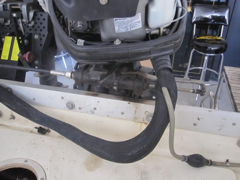

Does anyone have a pic of the seastar ram on their Opti 225? I want to check on something as the diretions seem weird or perhaps I'm missing a plastic spacer.
